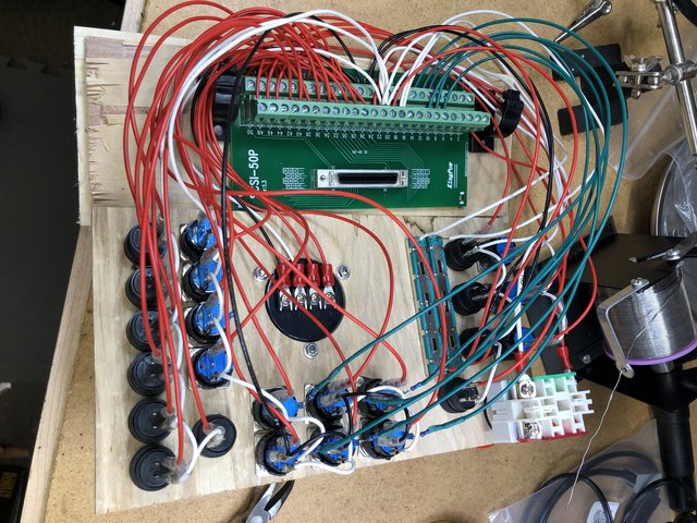

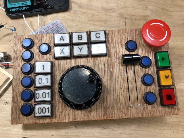

Having rewired the whole system with UCCNC motion control and CNC-Room breakout boards I achieved good calibrated motion on all 5 axes and then thought "Well with this much complexity it's time I built a proper CNC control panel with a manual pulse generator wheel."
My quick & dirty prototype control panel:
Which brings me to today where I am wiring up said control panel.

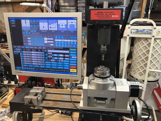

I'd love to see what your 5-axis setup looks like. I'm not sure if I could use such a machine if I had it :) Too poor for CAM software, so I write C++ programs to generate gcode in a slightly more user-friendly way than writing gcode directly. I do want to add a 4th axis, but tying to visualize 5 axis tool paths might be too much [uncle]
Thanks Dennis, I've shrunk the pictures and they seem to show correctly now.
The 5-axis setup is on my tiny mill. The rotary axes use steppers and 100:1 strain-wave or harmonic-drive gearing with impressively low backlash.
I'll also be generating the G-code myself using the Python component inside of Grasshopper. Fortunately I don't need any fancy 5-axis simultaneous motion, just simple 3-axis cuts but from 5 different sides of the workpiece. Figuring out how to calculate those positions will be an interesting challenge. :?

Another question for you, what type of mill do you have that you can cut with such tiny cutters? Do you have a high RPM spindle?
Love to see updates on this if you do any tests :)

Success at last! Your machine looks great :) Larger than mine at least, which has a work area of 175x150x111mm (wish I would have given it another 50-100mm of Z range). The exceptional feature of mine is that it only weighs 35lbs. I don't have room for stationary tools, so everything has to be light enough that I can move it to and from the bench easily. These photos are from various stages of its development, so you can see some features being added over time :)
My spindle is not very fast. About 4500RPM at the moment, though I could change to a 24V power supply to double that. I'm using an old computer supply. Just have to go slow with the tiny bits.
